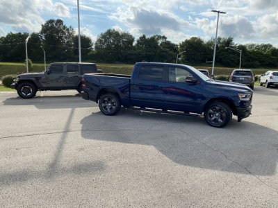

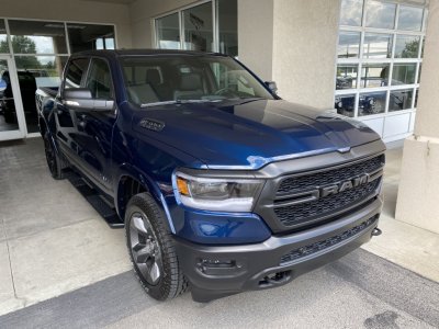

D47B34E7-E8FE-49CD-9C4F-923A0E8B418A.jpeg 76568F56-5CCE-49BD-918F-F54B27CB2937.jpeg I have 2020, 1500 built to serve. I wold like do level kit. But I r
I read, that 2 inch is better 2.5 what your experience is. I would also like to know which brand they recommend.

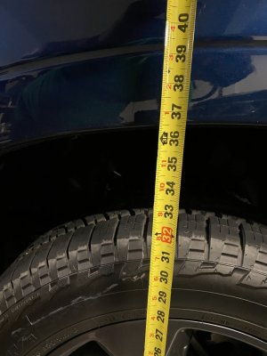

Here’s a 2” ready lift level kit. Top hat spacers and new UCAs.
Before:
2019 Laramie 2WD, 5.7 Hemi
