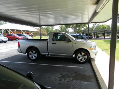

jeez. Ok. Here is before:

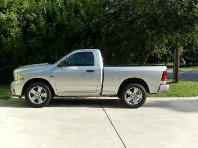

oops, after:

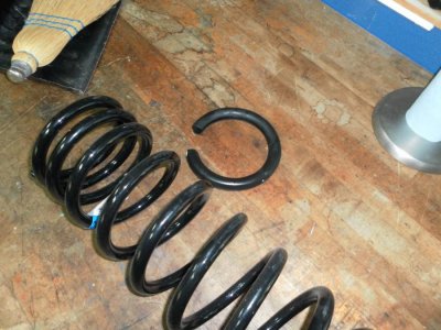

Here is spring cut:
