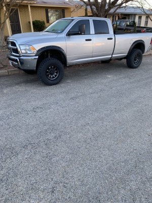

Hey all, back on the forum after taking a few years off due to not owning a Ram. But back in the Ram game as of a few weeks ago. This is my new 2018 4x4 Big Horn. I plan on doing a jack of all type truck (commuting, towing, mild over-landing) rig.
As far as the suspension, so far I’ve done the carli leveling kit with fox 2.0 shocks. Wheels/ tire combo is method nv 17x8.5 0mm offset with 35x12.5 Nitto ridge grapplers. Very happy with how this has turned out so far. I might look into sway bars later.
My question is for you guys running non factory rear airbags, I like the benefit of airbags while towing, but don’t like the limited travel while off-roading. Do any of you have experience with the day star airbag cradles? That seems to be the only fix I’ve come across for this problem. Also air lift vs Firestone/ what’s everyone’s preferred system?

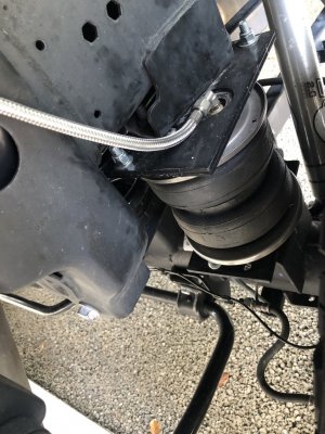

I ended up going the air lift route and I also ordered the cradles. I have not installed the cradles yet. From what I’ve seen you need to drill and tap a hole on the bump stop perch on the axle. Time wasn’t on my side when installing. Before I go on an off-road trip I’ll put the cradles on.

Here is how I did the daystar/airlift setup on my power wagon. Its been 2 1/2 years roughly and its been working flawlessly.
http://forum.powerwagonregistry.org/viewtopic.php?f=45&t=4732
