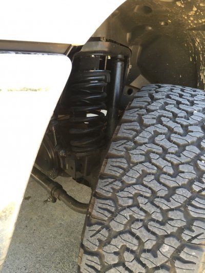

I have searched high and low and can't seem to find any info on replacement coils to level my 2015 2500 with the 5.7 Hemi. I don't wanna go any higher than where I'm at now, seeing as how my current truck sits the same as a 6" lift 1500, not to mention 1" taller than my last truck lol. ac724be61e968025c2025d007d57cb64.jpgI'm currently running a 2 1/2" RCX level and shock extensions (couldn't wait more than 250mi to throw on new wheels and 35s)04cac837c8f6dcb180fecd040d8a640c.jpg I want to upgrade shocks on all 4 corners and was looking at the Bilstein 5100s as I've ran them in my last 3 lifted trucks and loved them. I also wanted to swap out my spacer for a longer coil but only seem to find for diesel and the 6.4 Hemi.

There is no difference between the 6.4 and 5.7 as far as springs go; the trucks are the same weight. That said, there aren't any '14+ leveling coils on the market, Thuren has gas coils but they are 3"+ and require rear springs too. Your best bet is to order factory Power Wagon front springs and OE Bilstein Power Wagon shocks. The springs are +2" and softer than regular 2500 gas springs.

Ram already makes a OE +2" linear rate leveling coil. Order front Power Wagon coils.
