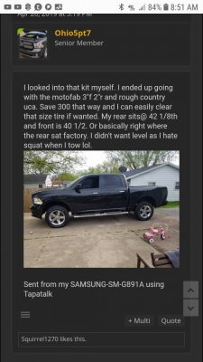

2" is fine I went 3" stocks would have been ok but I upgraded to rough country 3" upper control arms.Screenshot_20190807-085127_Samsung Internet.jpeg
