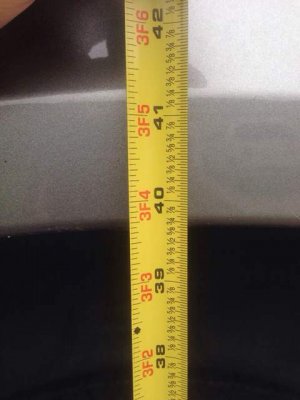

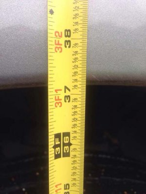

In the front im 37 1/4". ImageUploadedByTapatalk1410639683.614561.jpg and in the back im 39 3/4". ImageUploadedByTapatalk1410639741.730647.jpg
