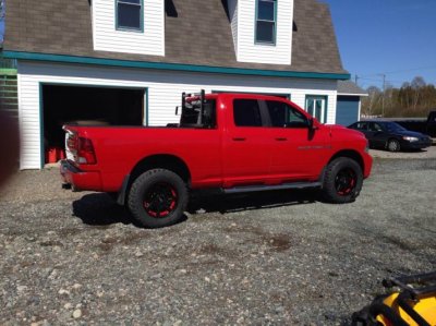

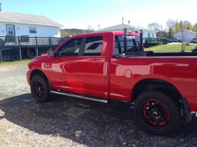

rough country combo lift, will run you 280 bucks and change, and you can swing 35/12.50 easily. also i installed the 1.25 spacer vs the .75 inch spacer in the rear due to i carry loads in the pan a lot. same may apply for you if your hauling other then that i love my setup. total lift on the combo lift is 3.75 inches 2.5 level + a 1.25 body lift.

it looks good man, I like how you still have a slight rake in the front to.
