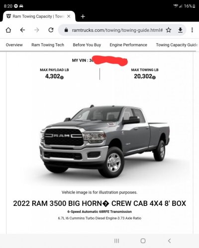

My 22' 3500 tow rating is way higher than that. If your towing that much I would step up to the cummins better fuel economy all around and towing/pay load is better in a 3500

Ride quality, the 2500 will have a better ride empty. Loaded, the 3500 is going to have a really decent ride.
You have to remember, the more options you add to the truck, the lower your payload is going to be. I like to play on the truck builder on the Ram Site, then search to see what dealers have that is closest to the truck that I built. Then I copy & paste the VIN into the cargo & payload search on the Ram site to find the cargo & towing numbers. Looking up the trucks on the charts will only get you a round about idea on what capacities are.
Search the specific trucks using the cargo & payload look up on the Ram site. Then you can play with the numbers and get where you need. @392DevilDog explains it well here:
