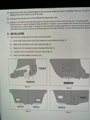

AEV requires the crossmember to be cut similar to the other brands.
