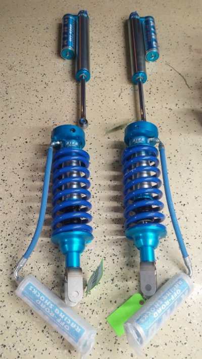

Well what that heck, i just placed my order of King 2.5 Coilovers with res front and rear.
Can't help myself when i see this damn deals, and King is King :)
Specs:
Rear
King 2.5 25001-208, 27.25" extended, 17.50 compressed, pretty much the same as my Rancho rear shocks, so i won't loose any flex, and still have reservoirs and a bigger displacement shock.
Front:
King 25001-207, 22.50 extended, 16.84 compressed, 1" longer than my Rancho struts.
I almost pulled the trigger on the Total Chaos UCA's tonight as well, but i want to take it easy, and like i said, the Zone UCA's i have are 4-5 months old, the Rancho have the same age, but it was always my idea to just move them out of the way to be my backup setup.
