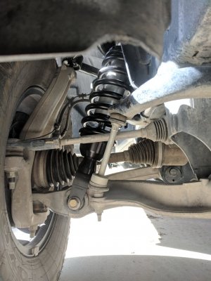

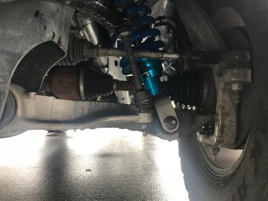

Looks good man! I was absolutely surprised how much mine settled. About .5-.75" after a bit. Be patient and fine tune it after a little. Angles look good. I ran my truck through a nasty snow storm yesterday, down the highway at 65 in 4wd and it gave me no grief. Our angles are almost identical so I really wouldn't concern yourself much with it.
I do think we need a full truck shot....just saying [emoji41]
As they break in the stiction in the seals will loosen up and it should make the small bump compliance a bit nicer. My 6112s are like butter after a few thousand on them now.
Btw I'm on 285s and sitting at:
39" front
39.75" rear
Edit: found a pic of my angles on my truck just for comparison

Oh she's ready for the adventure haha..

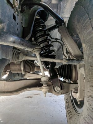

I think the CV angles are ok, You may have more than 2.5" if your front measures 39.5 with 285's ? she'll drop some anyways from where she's now as you rack some miles and the coil springs settle in full, then you can adjust up if you like.
This is how my CV angles look like today.
47086345761_9de167edcb_h.jpgUntitled by RAM RSM, on Flickr
46172881095_be60430128_h.jpgUntitled by RAM RSM, on Flickr

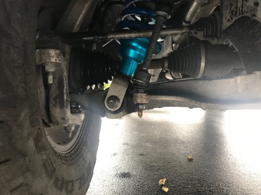

The upper control arm still needs to be tightened in this picture, right??
Nope. That's where she sits. It's a tapered pin coming off the delta joint, fully seated. Nut is torqued to 75 ft lbs and the taper pin isn't spinning so it's all snugged up! I wonder if this is why I'm getting extra height above what I was expecting to get...and what icon said I'd get?
Their coilover height (adjustable from 0-2.5" shipper set at about 2.0") is maybe based on either stock UCAs or their uniballs?
ram1500rsm
Jul 24, 2018
4,891
5,413
Trabuco Canyon, CA
You mentioned you adjusted the CO's? i'd assume this is why you're sitting higher at the moment, she'll go down once the coils settle for sure so just give it some time.The BJ's in the UCA won't give you lift increase. Noting wrong with the BJ they just don't have the grease boot because they don't need one like a normal BJ.

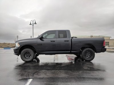

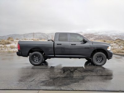

Here's what the rake and heights look like after alignment (just posted a thread about alignment, FYI).
Front about 39 - 39 1/8
Rear about 40 1/8 - 40 1/4
tires 285/70/17 (just under 33")
