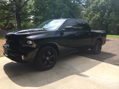

2014 2wd Black Express Ram (w/hemi) bought earlier this year. Looking for some advice on which route I should go. I'm wanting an agressive-leveled look (or even slightly lifted-look).
First off, do factory 2wd sit lower than 4wd? When I bought mine I didn't know it wasn't 4wd until I looked at the sticker and price. Ive been side by side to some 4wd and it's hard for me to tell the difference.
My rake is 2 5/8" currently.
1. I could go with a 3" CST lift coil wich would give me 2.5" or so of lift leave the rear stock height, get tires and move on to the next thing.
2. I could get a 4" spindle and 1.5" spacer, put tires on and on to the next.
Would I be sacrificing much ride quality by going with the coils? Do the spindles give a true 4"?
Tire options that I've looked into so far (open to other suggestions):
Toyo open country AT II 275/65r20 or 295/65r20
BFG AT T/A KO 285/65r20
What are your thoughts?

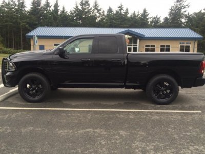

I have 4x4, but I used bilstiens and I'm running 275/65/20s

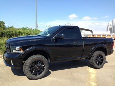

I have a 14 Express 2wd RC. I am running the maxtrac 4.5" spindles with 3" rear coil kit. $850. With 20x9 Ballistic Razorbacks and 35x12.5 federal ccougaria mt's. Truck rides great and handles good. Well as good at you would expect from Mud tires. Also still running stock UCA's with no issues after 2k miles. Also as far as ride quality I would say it would be close to stock if I would have went with a less aggressive all terrain tire. But it rides good. Most people that ride in it think it's smooth and tires aren't that noisy. Also I am only running the maxtrac shocks not bilsteins and find them as good as stock.

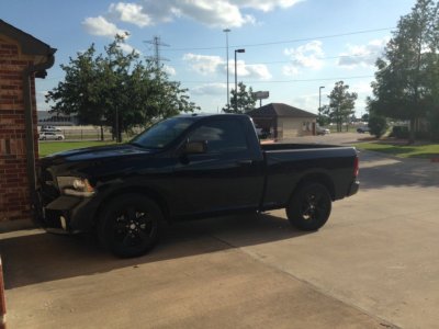

2014 Express RC Black Edition
Stock
