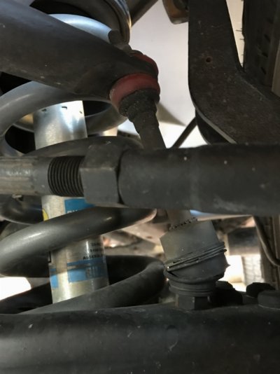

Hello everyone I had a question does anyone know of any way I can get longer sway bar end links or does a company sell them because my stock ones are not cutting it brand new it didn’t even last a year. I found some but I only see for 4x4 or 2500. Maybe I can get a longer sway bar idk anything helps.

Hey sorry never saw this post. I have the 4x4 sway bar links on mine and it restored mine to stock geometry. Mounts all work the same so for future notice this may help someone else or someone who is looking and hasn’t purchased the other thing

I am having the exact same problem, just replaced 3rd set of Moog problem solvers. I found a longer set at the local parts store by Energy suspension, but the bolt treads are too small.

Been through 2 sets over 2 years while running RC 3 inch body lift and RC 3 inch coil lift. Is the 6 inch RC sway bar links longer to compensate for this?

Get the 4wd one they bolt right in and are 3” longer.

I thought the 4wd was different then 2wd when I look at the pics there completely diff

I’ll have to look up the part number then. I got it from Oriellys and it was moog is all I can day off the top of my head

Moog K7422. It worked perfectly on mine
