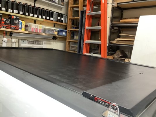

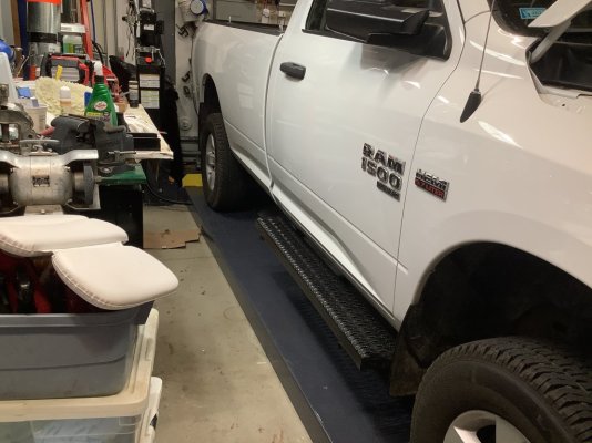

I know the tires look dumb but I got them just before I decided to lift it.The truck spent 2 months raised up and out of harm’s way after getting all the dents and scratches fixed but I was planning a trip to get plywood.Roll n is as old as the truck,works great image.jpgimage.jpg

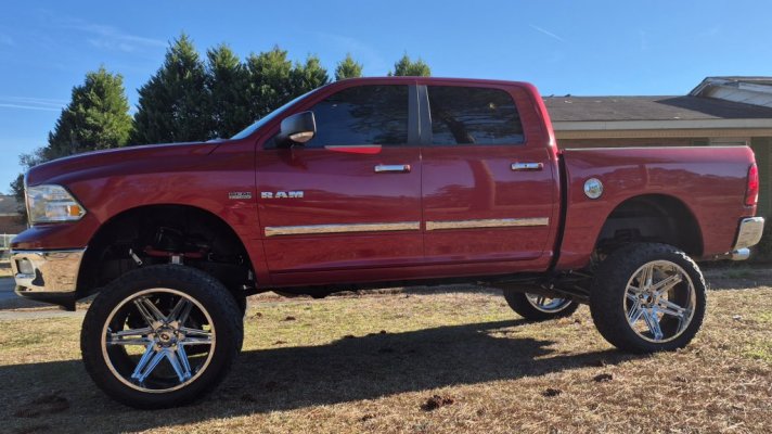

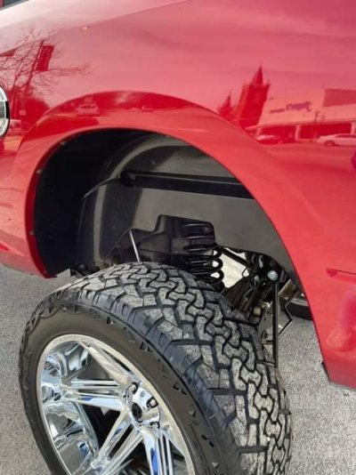

Reworked my lift. 6 inch zone stretched to 11" in the front. 5" coil in rear with 3.5" coil spacer. Core 4x4 adjustable rear upper and lower control arms with adjustable track bar. Also has 3" body lift.
Next up regearing the difs to 4.88 and 40" tires.

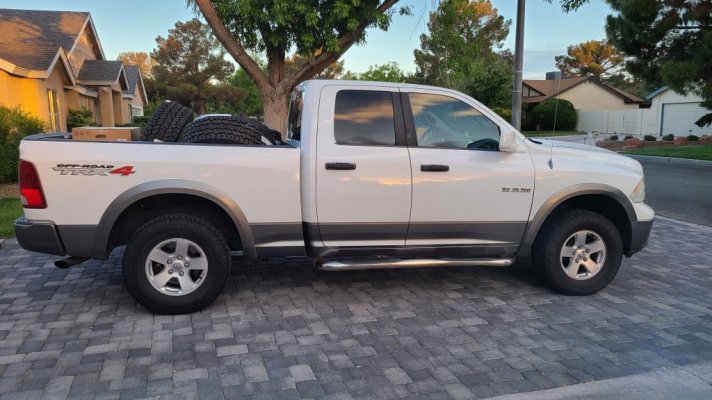

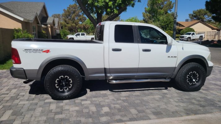

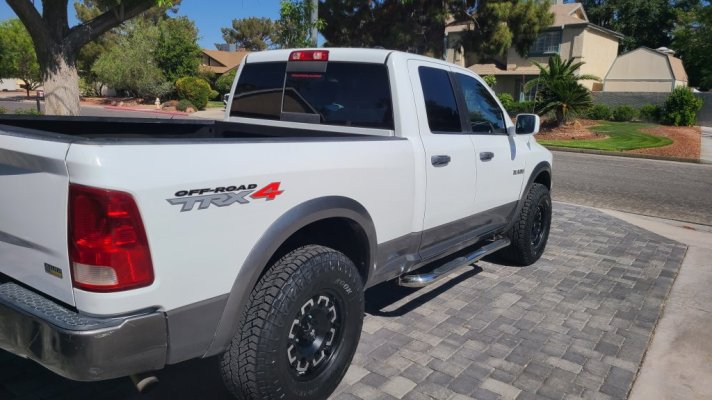

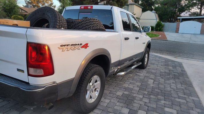

I leveled this a couple years ago at 2.8 with 5100s. Was cutting tires a bit on the front. Replaced the LCAs this week and replaced the 285/70r17s on stock wheels with 317/70r17s on 17x9 with -9 backspacing. No rub as expected. Tires to the lip of the fenderwell. Happy with the results.
Before.
After

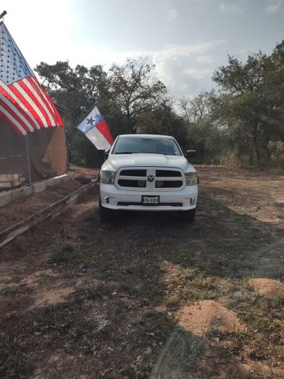

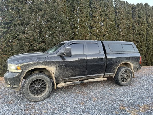

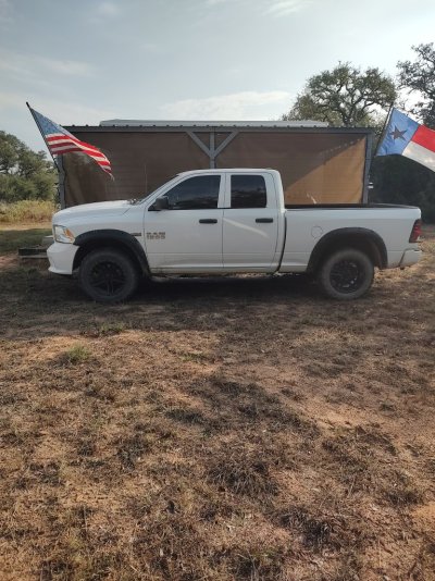

Good morning all! So I do not do forum interaction like I used to. But I wanted to throw my ride your way.
I bought my Express model right before I retired in 2021. It had 63k on it. 5.7 4wd. Perfect for my property and my home. I started buying parts to do a level kit. I was in no hurry to do this lift, so I took my time ordering everything. I have a part time job, so that money goes to things like that. Then 2 years ago, the HEMI tick got me. So that put me back a bit on the lift parts.
So here is a list of the parts, including the cam job. Bilstein 5100 shocks front and rear, Tuff truck rear springs. New factory original coil springs for the front, along with spring seat parts. Zone upper control arms. New Timken front wheel bearing kits. Hellwig rear sway bar with Hellwig end links. Front end alignment at a local Ram dealer.
Installed new Powerstop rotors, front and rear with pads. Powerstop red powder coated calipers also. Stainless front brake lines.
Misc. LED bulbs, including headlamps. Alpha obd makes it all work.
Last but not least, COMP cam HRT stage one bolt in cam, COMP lifter, Fel pro gaskets, factory cam chain, new tensioners, new water pump and green Gate belt. Mopar performance bolt in springs. I was not going to put this back together with the old springs. Diablosport tuner. K&N filter with a 6.4 truck intake snorkle.
Bottom line is the Ram runs great, and I love the look. And the picture of my truck looks dirty, and where I live, that is it's natural look lol. I hope you like it.
