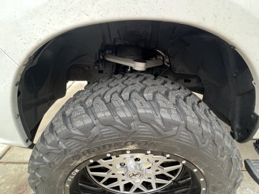

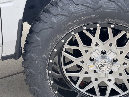

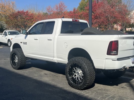

Hope you plan to add some fender flares soon, so as not to throw road debris all over whomever ends up behind you in traffic.2017 ram 1500 Sport
- Rough Country 6” lift with M1 lifted struts
- XF wheels 22x12 -44 on
- Hankook MT2 37x13.50
Some of you may know that I did the lift install myself. Took me 2 days to complete. Difficult? Not really. But You definitely need some time.
So far I absolutely love how the tires ride. I’m getting barely any sound. I’m very impressed with these tires.

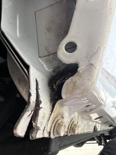

I will be cutting some parts off seeing it rubbs like crazy if you turn more than 45 degree angle.
As far as the ride, it’s a bit stiffer than stock but rides awesome.

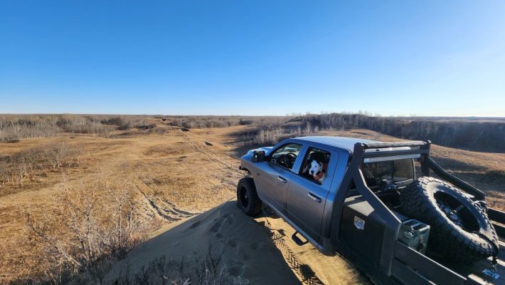

Looks like u and the pooch is getin **** done !

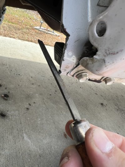

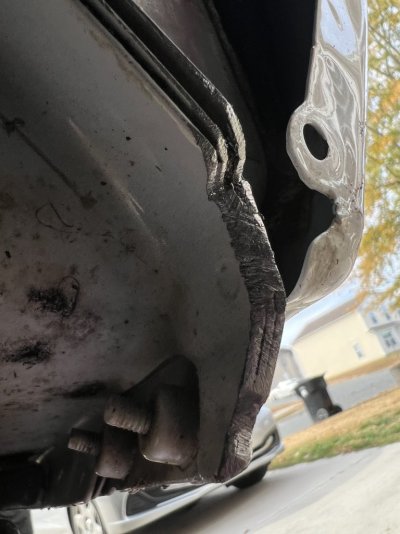

I'm sure you know ...but that -44 offset is why you are trimming the fender , something close to -18 would clearFender work. It’s still rubbing but not nearly as bad. I only cut metal on driver’s side.
But it doesn’t look nearly as good. life…..there’s always a trade off :/I'm sure you know ...but that -44 offset is why you are trimming the fender , something close to -18 would clear

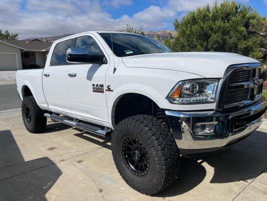

What offset?Got the new lift installed.
Maxtrac 7/5
Fox 2.0 all around
17in Methods
37x13.5 Yokohama X-AT

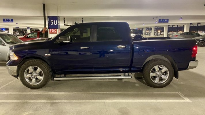

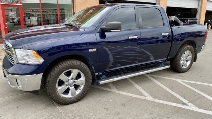

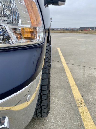

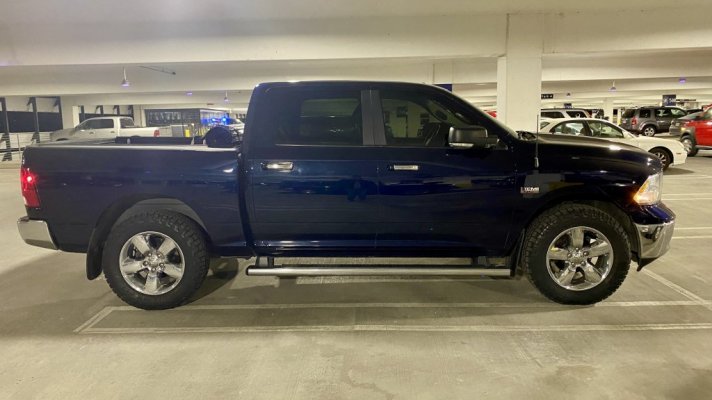

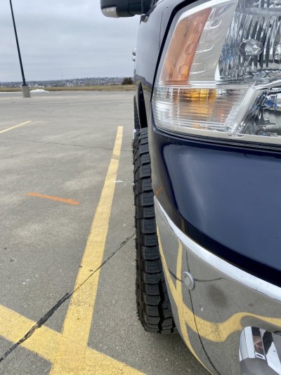

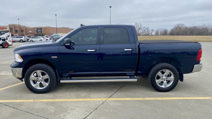

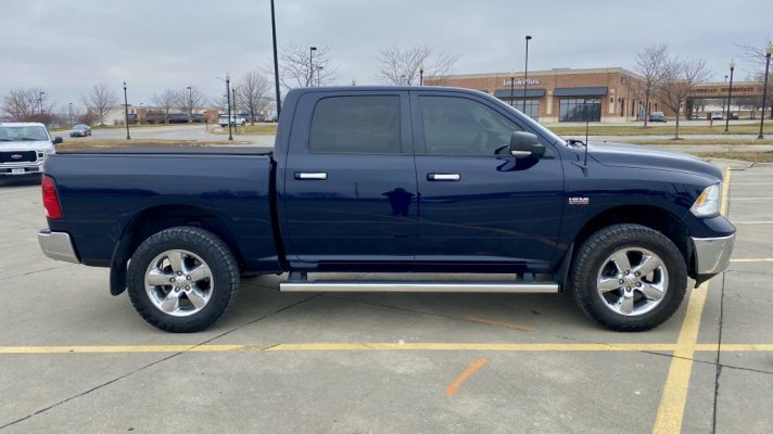

Just want to add that I settled on this setup in large part based on a lot of info and feedback in this forum, which was really invaluable. Got exactly what I was looking to achieve (which differs from person to person), and happy so far with the resulting ride quality and aesthetics.Stock height, brand new 275/65R20s Cooper AT3 XLTs. Debadged.
Bilstein 6112s @ 2.8” and ReadyLift UCAs front, Bilstein 5100s and MotoFab 1.5” spacers rear. Still have 1 1/8” of rake which is about what I was aiming for. (Some Icon 1.5” rear coils on the way.)
Also put on some 1/2” Titan wheel spacers with hub rings to widen the stance on my stock 20x8s.
