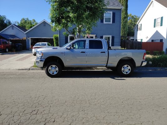

I got my lift kit today, it almost seems like the front is higher than the back... Should I have done a 2.0?

It still looks like the back is bit higher than front from your picture.

Thats what happens when you level them at the fender height...they will then appear a little low in the back.
Measure your fender heights. I have mine at roughly 3/4”-1” higher in the back (I went with a 1.5” spacer). Looks perfect to me. Not sagging ass, but still looks level.

It's weird I'm little unhappy with it... Maybe it's because first lift j have done independent of tires? (Coming later). It's 44" ground to top of fender for front. And 43" in the rear. So I should have gone with 1.75, or 2". I assumed a leveling kit is a leveling kit.f1145551f0e09d8070273048b5788734.jpg

Well, I guess thats your que to order up a 1-1.5” spacer for the rear haaaaa.
