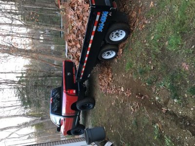

I lifted my truck about a month ago (6” zone) and every thing seemed great with no problems. Now I have a snapping noice from what sounds like my left side of my rear end. It’s only when I take off or stop suddenly. I gave it a quick check to see if every thing was tight and I didn’t feel any thing loose on a floor jack. Any ideas? Checked lug nuts as well and they were all tight. I’ll put it on the lift tomorrow for a better check.
Thanks for any advise.
