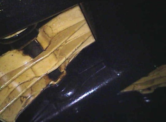

Well, I have a plan of attack. This weekend will be getting the truck up to temp, then running some seafoam through through the intake. Then pull the throttle body off and clean it. I have a bore scope for my phone coming in and I want to try and run it through the manifold and see if there are pools of oil or any other crud in there. I have a set of spark plugs and intake manifold gaskets on order. Plus I have the gearwrench spark plug magnetic socket and short extension on order.
Make sure you look at the inside top of the manifold when you're scoping it,as that's where alot of the crud build-up will usually be

Well, the weather has thrown my plans out the window. Snow tonight means, I don't want to let the foaming cleaner sit in the intake overnight. So, I pulled the throttle body. Wasn't near as dirty as I thought it would be for 106k miles. Cleaned it up, cleaned up pretty easy. Stuck my endoscope camera in and the intake is definitely oily inside. Attached is what looks like part of the SRV system. So, I bought a can of seafoam and stuck the straw in the intake tube right at the throttle body and sprayed the can inside. I went that route instead of the brake booster line because I wanted to coat the entire intake front to back. I had a half a can from before, so I used about 1.25 cans total. Then shut it off immediately. It's now sitting and hopefully the seafoam is breaking down any carbon on the valves and inside the intake. So, we'll see what happens in a few hours when I head out and put some miles on it.Screenshot_20251213-120745~2.jpg

Spent the day today pulling the intake manifold and cleaning it. The intake ports on the head were pretty nasty. I tried soaking the intake manifold with simple green and pressure washing it but it just wasn't cutting through the grime. So, I filled it with gas and sloshed it around and let it sit and soak. Repeated several times until the gas was coming out clean. Or mostly clean. The short runner valve was also noticably stuck when I started, but I wasn't throwing any codes for it. I couldn't budge the valve. After cleaning for a while, I was able to get it to move, but it would only rotate about 1/8 of a turn. With a camera inside, I could see 1/8 of them would move the valves quite a bit.
It took a lot longer trying to clean the manifold than it did to remove and reinstall it. Took it for a ride after I finished and it seemed to run fine, no check engine lights or anything. Real test will be how it runs when cruising on the highway, which will be tomorrow morning.
I'll use gasket remover to clean up the intake ports on the heads if they have a noticable build up of crud.
Do you have a catch can on the truck,as they do help to keep things a bit cleaner. They won't keep the intake and head ports spotless,but they do help to keep the build up mininiumized ,and usually keep the short runner valve working a bit better.

I have a catch can, the issue that got me into this mess was that I forgot about it for several months and never emptied it and it was over filled, so it was sucking in way more than it should have.
