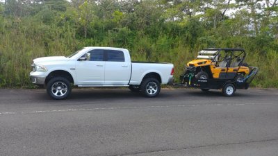

I couldn't find a universal kit that is tall enough. Obligatory picture of squatting truck:

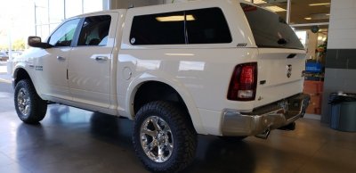

Leveled. 2.1 in the front, bilsteins in the back. 295x60x20 toyo open country AT extremes

So you put the Billies at 2.1+the 6” spacer on top of them?
The BDS kit reuses the factory strut assembly with a small pre-load spacer in it. I had the shop put in Bilsteins set at 2.1" instead of the preloaded factory strut assembly.

That spacer is only 1/2", maybe 5/8"? and it's a preload spacer not a top mount spacer, it doesn't push the entire shock assembly down in the same fashion a top strut spacer will + 2 of lift via billies, what did you do 4" spacer with billies at 2.1 then ?, but with the front drop for 6" ?
You can run the bils at max with a 6" lift kit so you get closer to 7-8" of lift, no difference than a stock truck running the bils at 2.75 as far as CV/steering angles etc
This. Only my Billys are adjusted to 2.1 instead of the max 2.8. With the 5" rear springs, the truck sits even. Looking into a Timber Grove airbag kit to address the squat when towing or packed with camping gear- It would allow me to empty the bag when the truck is not loaded up and / or when off roading with no load. I was surprised to see an application for BDS lifted trucks on their website!

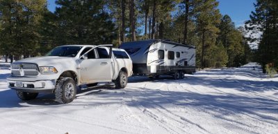

2017 EcoD 4x4, Airlift 1000 bags, 1.5 in rear billet motofab coil spacers 4inch BDS lift, Bilsteins all around, fronts at 2.5 w/3.92 rear, stock wheels on 295-65-20 Nitto Grapps, close to same as a 35...no spacers

Thanks, love this truck...It is just right now with the 1.5 inch Motofabs added recentlyElkhunt tow 1218.jpg , even with the Bags aired up to 50lbs too much sag from ARE shell weight and tongue weight on the recent Elk Hunt tow..pic is pre spacers..drops to level now hooked up to tow, truck is a towin beast regardless.

Thanks, love this truck...It is just right now with the 1.5 inch Motofabs added recentlyView attachment 151695 , even with the Bags aired up to 50lbs too much sag from ARE shell weight and tongue weight on the recent Elk Hunt tow..pic is pre spacers..drops to level now hooked up to tow, truck is a towin beast regardless.
A bit of the problem when towing is it actually lifts the front of the truck higher in conjunction with lowering the rear. Its like a double wammy lol. Were you using a weight distribution hitch with that travel trailer?
