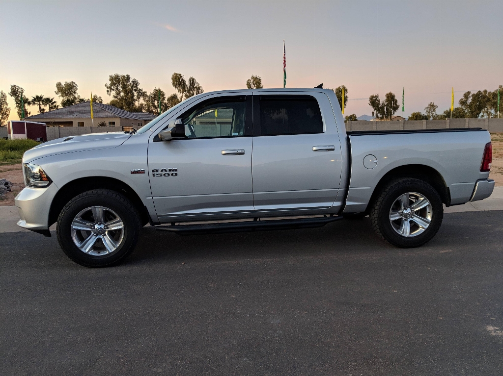

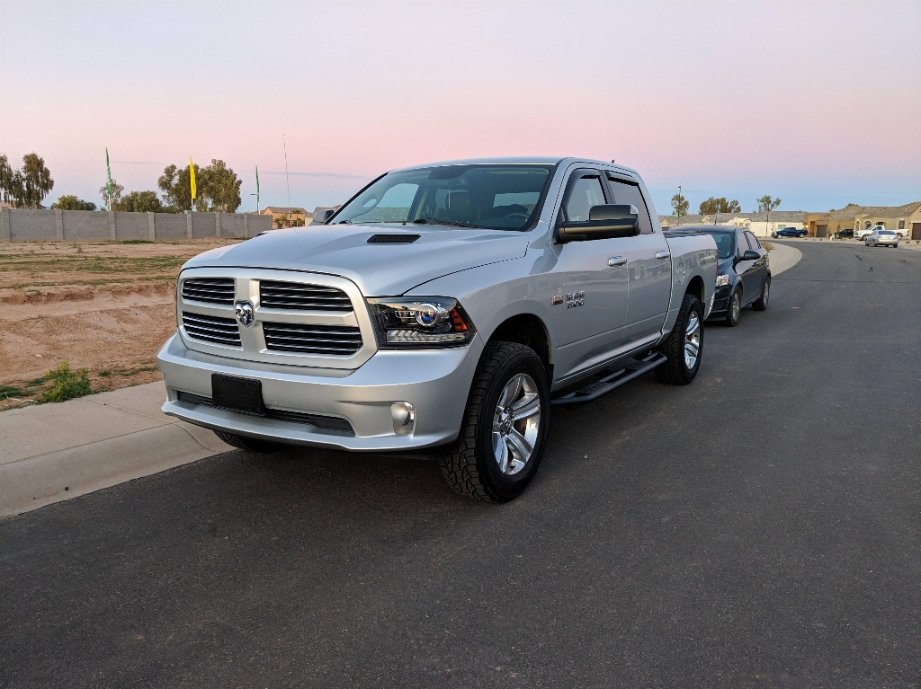

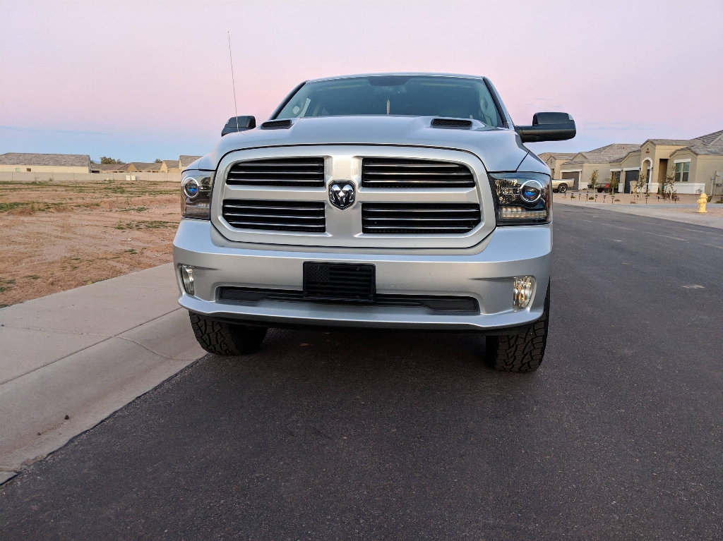

Bilstein 5100s and a 3/4" TGC spacer in the rear to match the 5100s set at 2.8" and new UCAs in the front.
Tires are Cooper Discoverer ATP 275/65R20s on the stock Sport 20" rims with no spacers, and I had previously swapped to TufTruck 1211 springs in the rear. I'm waiting until the alignment to do my final measurements.
