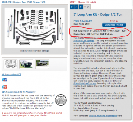

That kit is for a 4x4
I dont want to question your knowledge because it is obviouls beyond mine but the BDS website does not state if it is 2WD or 4x4 specific. Are you certain of this? I would hate to buy it and it not be compatible.

Yep definitely for a 4x4.
How high are you looking to go? Or more importantly what size tire are you trying to fit?
thank you. I am looking to lift it 4"-5". I am not certain of my current tire size but plan to replace them along with getting the lift. Do you have a recommendation? I am looking at the rough country website now. What should I consider in getting the lift kit and new tires? I appreciate your attention to this.
