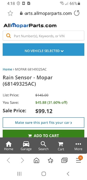

This should be the one that fits your truck. It's the one I ordered for my 14 1500. There are sections to calibrate the rain sensor in the Alfa tool but I'm not sure if you would actually have to do it. There have been a few guys who have upgraded to rain sensing wipers and installed the rain sensor and simply enabled the codes without doing any calibration and they seem to work fine. You can install it and see what happens. If it doesn’t work correctly you can try calibrating it with the Alfa tool if you have one or possibly have the dealer do it if you don't want to attempt it yourself. d0c63ad5232cb41eece1ebea27e120f0.jpg
