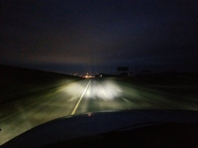

The main issue I have is the housings, they're garbage. The LED bulbs aren't bright enough to blind anyone but they're also not that good either.
https://imgur.com/a/293Ji
Pictures for example I've got them adjusted as they should be since they threw off light higher up than the bulbs that came in the housings BUT even with regular bulbs the light was scattered like that crap too.
It was a terrible idea and unfortunately I didn't think to ask until I ordered them. :/
SPPC Crystal Headlights Chrome Assembly Set with Corner Light For Dodge Ram - (Pair) Includes Driver Left and Passenger Right Side Replacement Headlamp https://www.amazon.com/dp/B00JBIACJG/ref=cm_sw_r_cp_apa_KGpxAb7SFWJ7B
And using Auxbeam LED Headlights F-16 Series 9004 HB1 LED Headlight
The light pattern these housings produce with both bulbs is pretty unacceptable.
So that's why I'm asking.
I've been sitting on the sport mod idea for a while now though. I upfit cars to emergency vehicles for a living so requiring the headlights with relays wouldn't be a problem at all since I have everything I need to do that job here at the shop.

Sport mod is good.
I had those same headlights with halogens for a bit and here is what the pattern looked like
Damn, it was probably the bulbs I had then but it looked exactly like my LED pattern just dimmer. Thanks for the help guys. I think I'll go sport and relay it. Any recommendations on what brand to go with for sport housings? I know there are some cheap knockoffs out there so suggestions are welcome.
I was also thinking about going with Philips X-Treme vision. I agree 100% about Sylvania their bulbs don't last long and aren't even all that bright.

What about these are not blinding?

Yes those are blinding. Mine aren't that bright. Mine are more of a halogen bulb replacement brightness.
Like that.
Mine aren't getting reused though. They'll get junked or thrown in a box and forgotten about.
