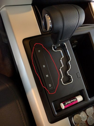

Quick question are those letters supposed to light up? I would think they do but I just noticed mine arent. If they are where/what should i be looking at to fix them?

I have a 2012 and they light up. However, i don't know where to start looking. I didn't look into it all that well.

Thanks, Ive got the same answer from a few other people. I'll have to take it apart and see what the deal is.

Please post the fix. I have a 2011 Laramie and mine don't light up either...

I don't know any that light up on the console......I thought it all showed up on the cluster.....

Ok so there is a little light under the console for the letters. Easy to replace. Hard to find the correct bulb. The OEM taken out was ewg203. After a little searching it seems the new number is e74. Some guys said the Sylvania 74 was a tad too big but I went and bought them anyways. $5 for 2 at autozone. It definitely is a much tighter fit but just a little pressure and they fit snug and they work fine.

I had the same problem in my 2011 while under warranty, dodge cannot get bulbs so they replaced the entire shifter, happened twice
