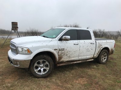

I recently upgraded from a 2009 TRX4 to a 2016 Laramie, installed a 2.5" lift/level kit and 35" Goodyear Duratracs. Made my first trip to the ranch this weekend and nearly got stuck in a hole I've driven through hundreds of times because the new truck didn't have positraction/limited slip in the rear like my old truck did.
What options do I have to upgrade the rear diff for $500 or less?
