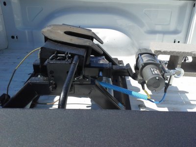

I did it with a cable and padlock. This pic isn't great, but you can see the cable runs beneath the mounting rails, between two rails of the lower mount, and thru an opening below the fifth wheel plate.
If you're wondering, the receiver underneath was welded on later, so I could mount the winch for pulling my (heavy) boat up onto it's trailer.

I would think the weight of the fifth wheel hitch would discourage most thieves. Locks, for the most part, keep honest folks honest. I've never seen an off the shelf solution, you may have to fab one up yourself. Make it complicated enough to discourage the crook so they move on to an easier target.
