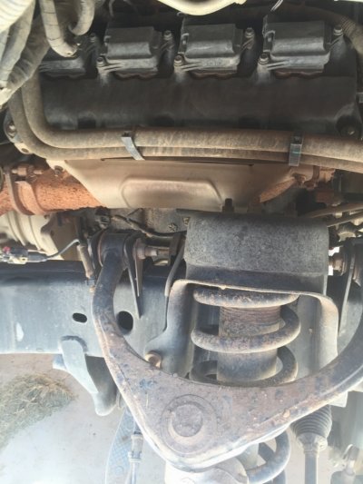

I took off the tire and the inner plastic tire well to check out where I'm going to be putting my headers, and I successfully broke off 100 % of those black taps that are a pain in the ass to remove.
But anyways it appears that the coil is going to be getting in the way, is that something I should remove before the install or can you work around it?

You can get to all the bolts from inside the fender there. Just pull the fender liners and front wheels, and you should be fine. I like to unclip those 2 heater hoses to give yourself a little extra space as well.
Only tricky part of this install is getting to the lower oil dipstick tube bolt on the driver side. Its very easy on the 2wd trucks, but there is not much room to access that bolt on the 4wd trucks.

I sat there for a while just arming it lol and I think I can knock it out and lure a friend over to help with whataburger and beer (insert rolling laughing face that Tapatalk doesn't have)
