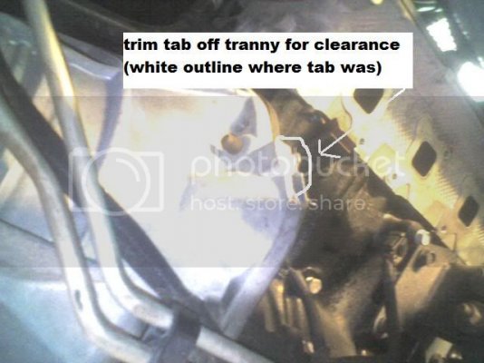

I installed them on my 05 quad cab and had to cut one small piece. It's a tab on the tranny that's in the way... not hard to cut at all and wont affect anything. That was it. I'll find you a DIY here in a sec.

They have a 3" collector, the stock manifolds have a 2.5" collector from what I recall, I cut the tab off with a hacksaw, and I love my Pacesetters, I got the Armor Coat and had a full custom exhaust built off of them. I wouldn't trade them for anything. :)
