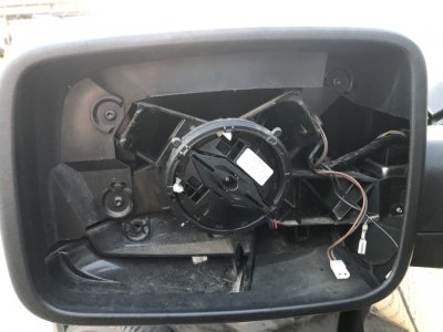

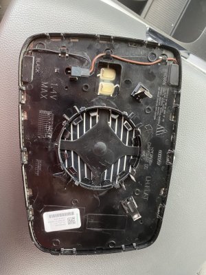

I've got a 2018 Ram 1500 and the driver side mirror shattered. The mirror housing is fine. Everything works. Just need to find the glass. The problem I'm having is the mirror housing has a round mount for the mirror. All the mirrors I've found so far have a square molding with two tabs at the bottom for easy installation. This doesn't work on my round mount. It's not an after-market mirror.
I'm attaching a picture of the back of my broken glass and a picture of the mirror mount in the housing.
Can you help steer me to where I can find a replacement mirror glass with a circular template on the back instead of the square template?

I have been in the same situation. If it's an auto dim mirror be prepared for some sticker shock. You can easily find a complete used mirror for the price of the replacement glass. If your mirrors are just the standard non auto dim style the price isn't nearly as bad. As stated Benny # allmoparparts.com in the vendor section can hook you up.

I know that the dealerships have them in stock, check with Benny as mentioned above
You will have to have some information
There are mirror glass with 2 wire connection & others with 3 wires, there may be other options
Both of them will fit into the mirror housing
Do Not toss those metal fingers away, you will need them on the new mirror glass

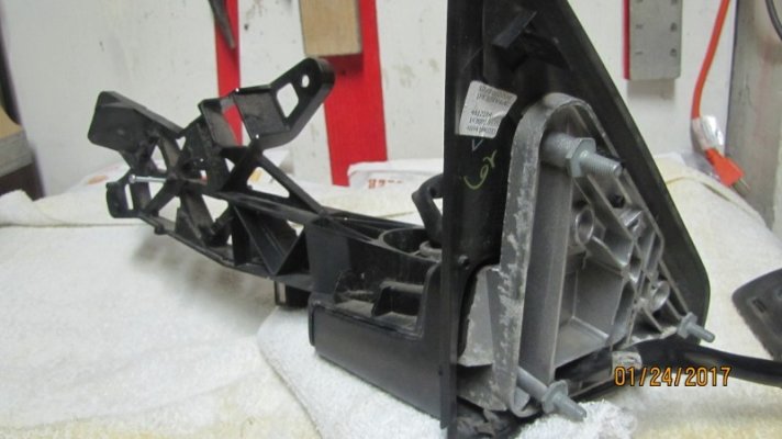

Something else to look at, just so that you will know about it.
Before you replace the glass, look at the bottom inside of the mirror housing
Do you see the black clip in the bottom center of the housing
If you push it over just a bit, it should release the light in the bottom of the housing if i recall correctly.

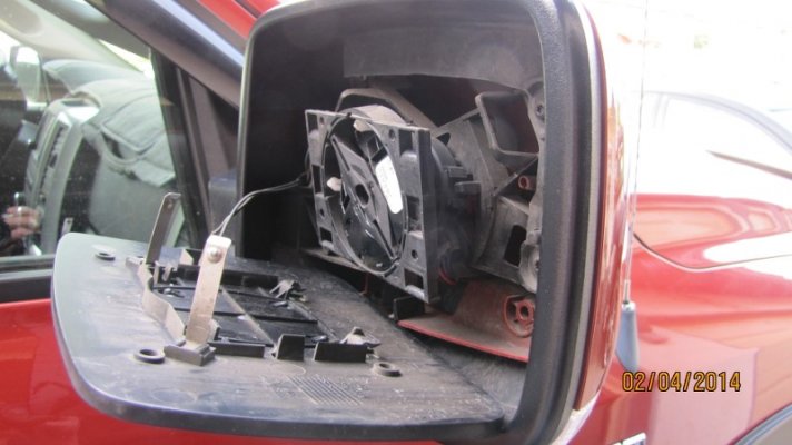

This is a 2009 passenger side
if you look closely, you can see the black clip
the mirrors do come apart & it did not take long
This was the drivers side a couple of years later, i believe someone was using a baseball bat from a driveby
light on the back side of housing

Thank you. I was able to take the old glass out with no problem. No one can seem to locate the glass with a circular template though. Every auto store I’ve checked can only find the rectangular one like you posted. They said they checked the Mopar website and couldn’t find it either. Contacting the dealership in the morning and crossing my fingers that they can find it and not charge me an arm and leg.

Found the mirror on eBay 70 bucks

They sell the glass on eBay for like 70 bucks part number is
68381787AA​
