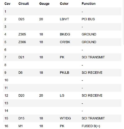

I am in search of a wiring diagram for the ODB port on a 2002 Ram 1500 4.7L. Mine fell apart.
I have searched high and low and cannot find a color wiring diagram.
Any help would be appreciated I am in a pinch with an engine light on.
