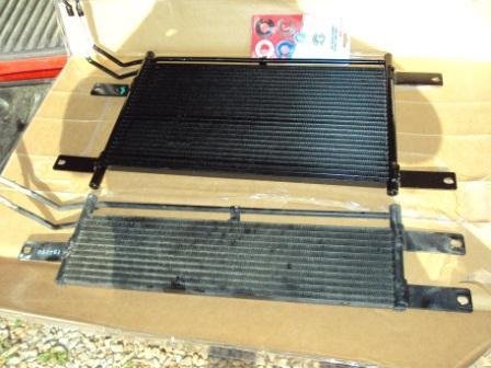

I just installed an active trans cooler in the rear, above the axle. all new plumbing, and secure mount to bottom of bed. The cooler will clear full axle articulation, and is clear if the drive shaft snaps.
Pictures will follow later.
This freed up space in the front, for the real project. I'm going to swap out the stock radiator for an after market alum radiator.

DaKing
Oct 21, 2010
215
116
6.4 HEMI
here is the connections to the transmission. note the heat covering on one of the lines. the other line is steel braid.
Here you can see the steel braid line better. I had to go steel cause it comes close to one of the header pipes.
In this picture you can see where the 1ft long steel braid line joins a regular braided line. also the heat coved line. these two lines are placed over and on top of the factory exhaust heat shield. Cheffing is eliminated by securing the lines to the bottom of the cab floor, and the thick heat covering.
The cooler is mounted above the rear axle.
I'm not completely done yet. I want to replace that cooler with one that had NTP or DASH - fittings.
