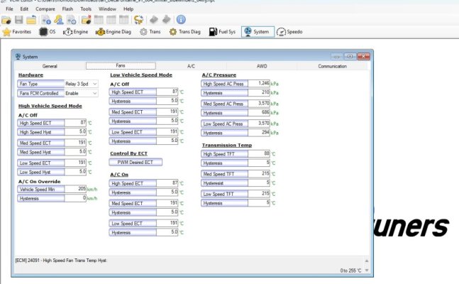

This is what FRP set mine with a 180 high flow t-stat and V6 fan ;)
Engine stay cool AF without the need of that stupid clutch fan.
