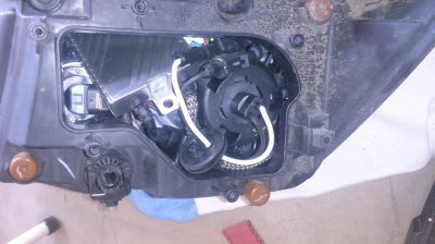

This is what I did... Here are some after pictures... btw these are the Philips 9011HIR bulbs. About $30 from Amazon.
The thing with HIDS are that the projectors are designed for halogen bulbs. Like a member mentioned above, they have been flashed by other drivers because the light isn't projecting correctly. If you want to do HIDs properly and not blind others you should look into a retrofit. Putting HIDs in halogen housings (to include halogen projectors) is generally frowned upon on popular forms like HIDplant. Mostly because what I mentioned above. 08dd5857474ebc09fdf7e3ba25a2faa7.jpg
