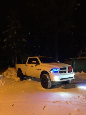

Im trying to get ideas on the lift for my truck. Been debating on just getting a 2" level or going with a lift. I have 2012 ram express, quad cab, 2wd. I know theirs not a lot of options for 2wds, im just trying to see what others have or ideas. Any pics or info are appreciated, thanks

Check out MaxTrac if you're looking to lift/level your 2wd.

are you running a 33 or is that like 34? is the rear stock?

Rear has their 3" coil springs and I have 35's

The kit is nice. I have the Maxtrac 4.5" spindle kit with the 3" rear coil kit. Cost me $850. Rides good and looks nice. Clears 35x12.5's easy. If you want a 35" tire this is the way I would go. Rides the same as stock well except for the fact I am running mt's which do make a little hum and aren't quite as smooth as a at tire but I don't regret is. Much better than a level kit in my opinion and there is no UCA issue.
