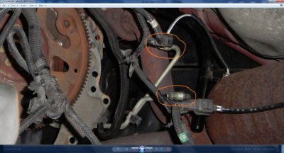

From the trans yes, for the cooler you need the quick disconnect tool. You can see the hex heads on the cooler lines circled in orange.
