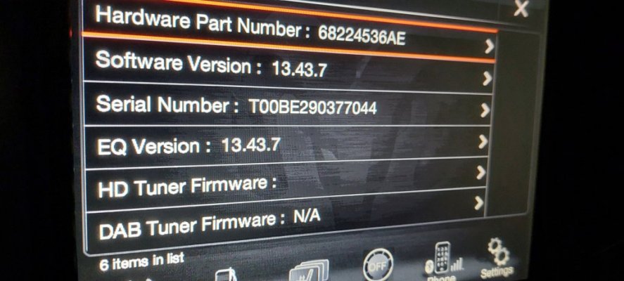

Truck year: 2014
Software version: 13.43.7
Hardware part number: 68224536AE
Please let me know if you need any additional information.

Truck year: 2014
Oh heck, you have a 2014 radio for another country I assume - RoW? ... (Yep you're not in North America per your profile).
Note:
2014 Ra4/Vp4-NA , PN is 68224525Ax (USA)
2014 Ra4/Vp4-CA , PN is 68224537Ax (Canada)
Your Ra4/Vp4-RoW, PN: 68224536Ax (Rest of World/Export)
Unfortunately, we don't have any SW here for your radio. (Just USA & some Canadian stuff).
If you can find it, you will need to update to v17.x first, then you can update to v18.x for your country.
