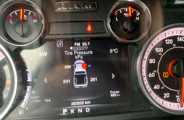

This low tire sensor warning is driving me nuts!! It says front passenger tire is low and then show -- for loss of connection. I rotated the tires to see if it was the sensor in the tire and the problem stayed in the front right. So it may be the module or wiring to the module?
After rotating the tires, I added air to the rear tire and the tire pressure monitoring system showed the rear tire filling up so its defiantly not the sensor in the tire.

Okay was able to read the modules and got a code after all!
C1502-96 - Tire pressure sensor 2 - Component Internal Failure
C0077-00 - Low Tire Pressure
I was able to unhook and remove the module under the front driver bumper area. The harness was dry and spotless, the wires looked near brand new and the inside of the box was clean and dry as well. The circuit board looked good on the bottom side. Could not see the top side of the board without ripping it out. So is the module just bad or is there more to this? I don't like replacing parts with out knowing for sure.
I noticed my scanner was only showing a tire pressure for tire #3 and no other tires at the time of scan which was weird. All the sensors reported back Battery Low = No
