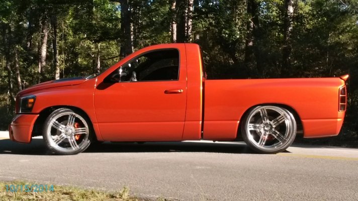

Sorry for the late response
Michigan metal works
4" raised and offset upper control arm mounts
Mmw offset upper control arms w/poly bushings
Djm 3" drop lower control arms
Custom front 2" drop springs with a 1100 lb spring rate
Razors edge bump steer kit
Hotchkis front sway bar with polyurethane bushings
Front frame section was trimmed
Shortened sway bar links and mounts
Ride tech drop shocks

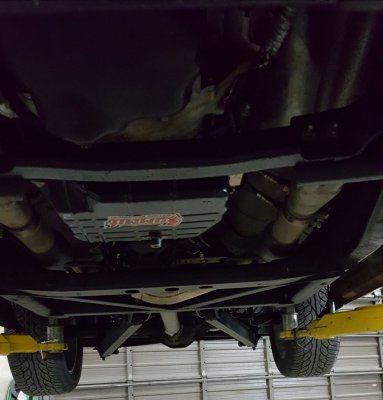

Rear end is from a Rc
JTSVP 2" drop blocks
Custom c notch w reinforced frame
Custom Rear end shock & mounts
Custom leaf spring pack with
Carrier bearing crossmember raised 3"
Jmb performance traction clamps for leaf spring packs
Hotchkis rear sway bar flipped & spaced down with shortened links
JLT super 60 drag bars
Lethal Hemi

that thing back on the road yet?
Nope I’m basically rebuilding this truck.
New 15k motor,
New Paint,
New suspension,
New fuel system
New wiring system with Holly EFI
New transmission that needs a lot of custom work done to it
So basically I’m close to 30k into this build and it won’t be done for another 4 month easily. I took time off from this truck during the holidays. I’ll start back up next week.
I’m ready to have her back but getting annoyed with all the money I have spent on her. It will be worth it at the end with a 750hp all motor truck cruising down the road.
Then I need to get rid of these 22s up front because I need more narrow wheels due to the suspension
