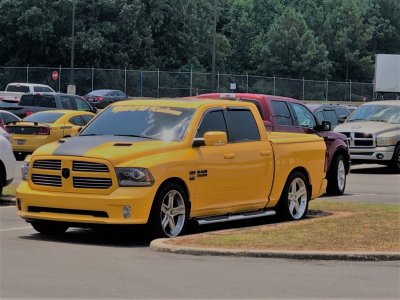

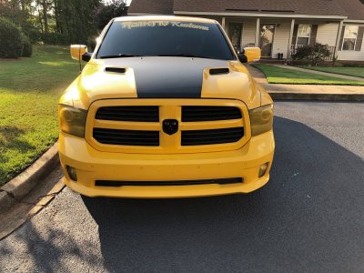

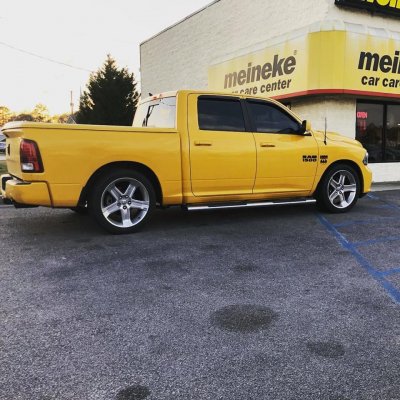

Wasn't able to get full side shots on level ground, but yesterday I removed the truck hemi badges from the fenders and replaced with charger/challenger style hemi badges. I really wanted the fenders to have some hemi identification on them, but the truck ones were just big and kinda ugly to me.
20191018_135242.jpg 20191018_143722.jpg 20191018_150435.jpg 20191019_134725.jpg 20191019_134735.jpg

i don’t see the rear being dropped 5”. It looks like it has 1.5” of rake. If it was 3/5 it would be level, no?
The pic in your garage looks like the rear is dropped way more than this but it’s in dark shadows so you can’t really see the fender gap.
Look at the rear fender gap in my avatar. That’s a 2” drop. I can’t imagine yours is 3” lower than that.
