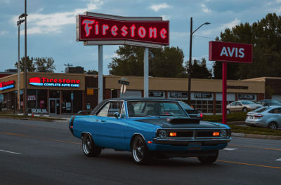

Here is my 1971 Dart Swinger, 383 Big Block, 727 auto, 8.75 rear with 3:55 gears. Photo was taken while cruising one Saturday night.
