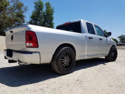

nmoosekeys
Jul 7, 2016
All done! Here's what it looks like now with the belltech lowering kit and 20x9 +0 wheels and 305/50/20 tires :)
Dubstep Shep
Aug 4, 2014
2,240
514
Houston
2014 R/T
I had problems rubbing with the SRT-10 wheels and tires with the Belltech kit. It's one of the reasons I took it off.
