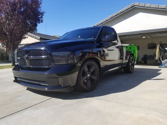

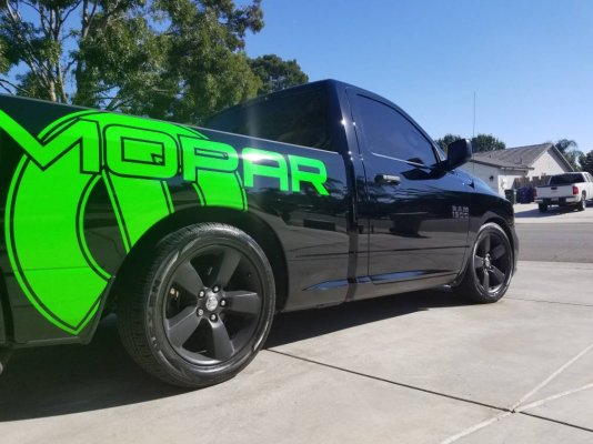

I went with the INEZ drop lowering kit 4/6...couldn't be happier..and it rides better than stock now. No stiffness at all. Comfortable. 96415357bf0b30f04732084efca2c966.jpged3ee6b101a59dcf2489b43496bde3b7.jpg

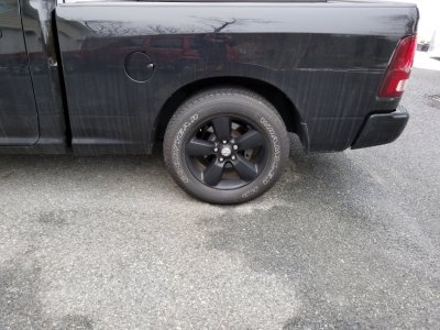

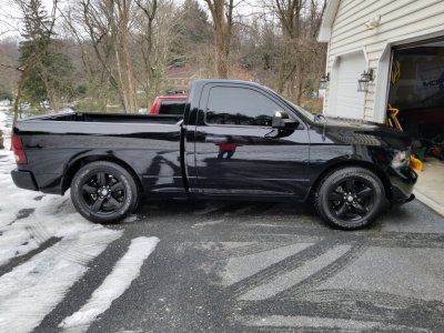

I just picked up this 14 last week also, im guessing it has a 2/4 drop. Cant tell what springs though. It rides better than the r/t i test drove. What part of Pa are you from, Lancaster here.20180209_112508.jpg 20180209_112538.jpg
That's a beautiful truck, love the graphics and color choice!

I just picked up this 14 last week also, im guessing it has a 2/4 drop. Cant tell what springs though. It rides better than the r/t i test drove. What part of Pa are you from, Lancaster here.View attachment 120844 View attachment 120845
looks like you need get the panhard bar relocation bracket, that pic makes your rear wheel look sucked in to far
Isnt that to center axle left to right, like a track bar does up front? I need the illicit brackets for the control arms though, i get the 75mph shuffle on bridge transitions....lol

no im talking about the bar that keeps the axel centered from left to right, i know with a 2" drop it pushed my axel about 1/2" towards one side, it drives my OCD crazy, that pic i quoted it looked like it was sucked in a good amount
Haha, i hear ya! I just looked when i took those pics, theres a little difference. Passenger side looks in just a touch. Id have to take measurements on level ground. Front drivers nose is downhill and passenger rear is uphill right now as it sits.
if you didnt notice it before then you will now so you're welcome haha!
