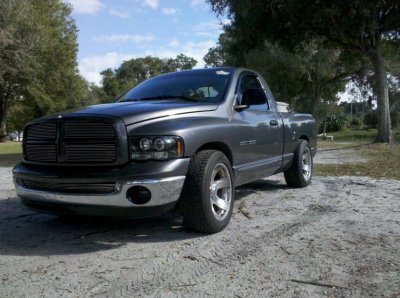

hey yall took be and a buddy about 4 hours but its done...let me know wat yall think
thanks

nice drop. Just makes me a little more unpatient about doing mine

Well i love how it looks just rides rough..is there ne thing i could do to help that??

Did ya change the shocks? stock shocks might be compressed enough to make it ride rough.

x2 on what shocks?
Also check the front bump stomps to see how much clearance there is from the LCA. Chance those coke bottle size bump stomps are touching.

Ya you will need to get smaller bump stops for the front. Also take out the rear bump stops. You don't really need them. And last but not least... drop shocks. I recommend Belltech Performance drop shocks.

OK yeah I have the stock shocks on it so ill see about getting some new ones. As for bump stops they are on as well...thanks guys
