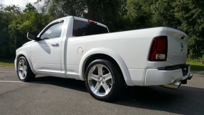

If you can find the kit, ground force 2/3 . No need for no cut brackets, only thing I added was the adjustable panhard bar. This is on my 2018 single cab sport. Had the beltech and all the other BS on my 2016, this kit is much better.
