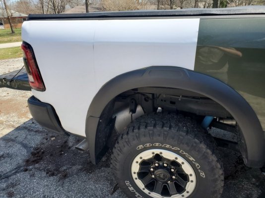

Getting started. I made templates with kraft paper and am working my way forward. Once I get the passenger side done I'll use these pieces as templates for the driver's side. My son is going to paint them for me. I may cut the larger pieces in half to make installation easier once I've got the whole truck done, the big sheet in the back grabs quick and it took me a couple of tries to get it lined up right. The magnet is strong AF there's no twisting or moving it once it grabs.

So if I was doing it all over again, I'd:
Cut the rear doors longer so the flap covered the bit of the cab behind the doors. With the crease, a small piece doesn't stick very well. I have enough spare material I may recut these before the next outing.
Cut the section by the tail lights in half, which I'm going to do anyway. The pieces are too big and unwieldy as they are, making it hard to line them up good before they stick too much to wiggle.
Otherwise, I'm pretty happy with how they turned out and performed.
