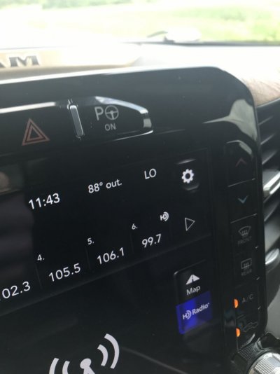

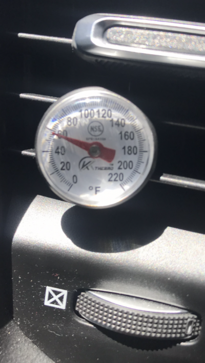

I had that TSB done last summer. I was worried about damage to my leather dash but no issues and the A/C works much better now. Totally worth it.
Before (58F) and after (46F)
