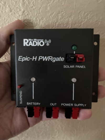

Well aware, but no. The current requirement here is intermittent and continuous running isn’t necessary. I have a secondary 50ah LiFePo4 battery behind the seat as kind of an UPS anyway. Worked on Motorola gear for years. I just wish I had this technology back then.
