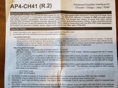

Unfortunately this doesn't work for my 2013 Ram 1500 Outdoorsman. I didn't realise that and I ordered the PAC AP4-CH41 (R.2) only to see in the notes that i can't use it. If i use it i have to amplify all the speakers, not just add a sub. I called PAC and they confirmed this.
I also tried the LLJ customs tee harness LOC kit kit. Unfortunately when i hooked up the tee harness my radios volume range decreased. I emailed and texted LLJ customs and they don't respond.
I dont know what to do now.
This is good news for us without the premium sound system but PAC released this new ampPro that doesnt require a stock amplifier. Was wondering if anyone has used it or the older version of it with the premium system and how the results were? fix the bass rolloff and give you clean signals to work with?
P/N: AP4-CH41 (R.2)
