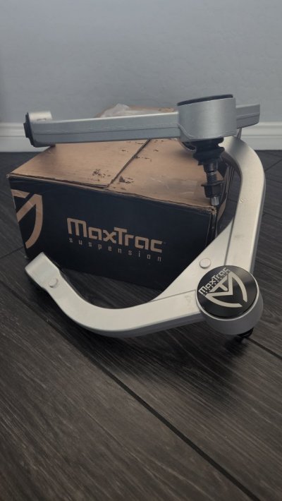

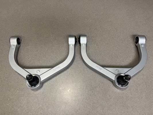

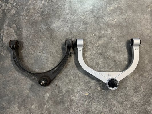

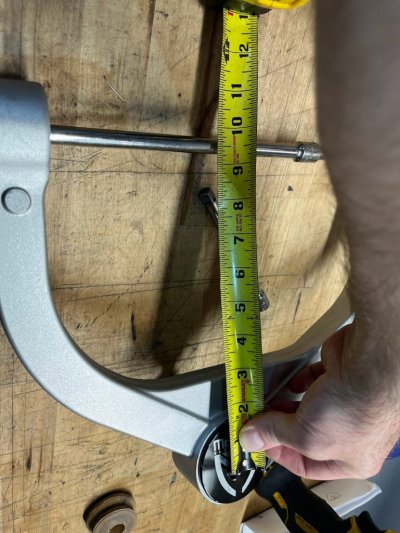

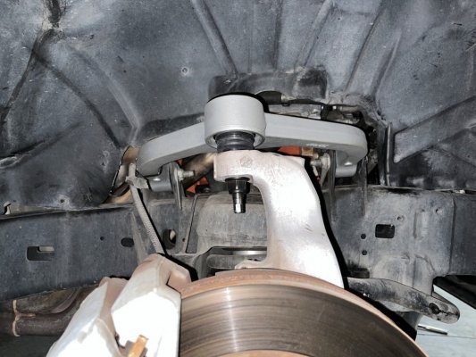

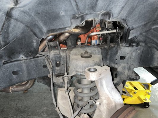

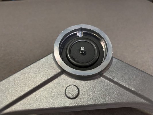

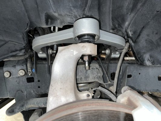

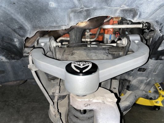

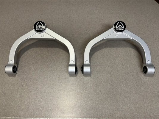

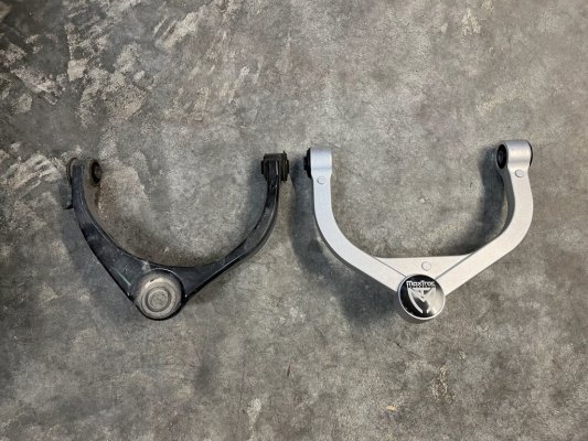

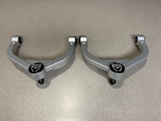

I had a buddy turn me on to these upper control arms to address my camber issues since the Belltech 2/4 drop. I had it aligned at dealership about two yrs ago and at the time he needed more positive camber but said it was close. It has been fine since. I noticed the other morning that I had a a lot of negative camber, springs must of settled. These MaxTrac control arms cost me about $330 shipped and are forged aluminum that ad 1 degree of positive caster and 3 degrees of positive camber with greasable ball joints that are very high quality, part # 352700. The instructions want you to remove the tie rod end but was not necessary, one of the best mods for the money and took every bit of 1hr to complete with common tools and a torque Wrench.
UPDATE:
Was aligned today and they had it adjusted in a about 30 mins! He said it was perfect and it drives perfect, the first time it was adjusted after the drop kit two yrs ago, they screwed with it for about 2 hrs and was still off. Very Happy!
