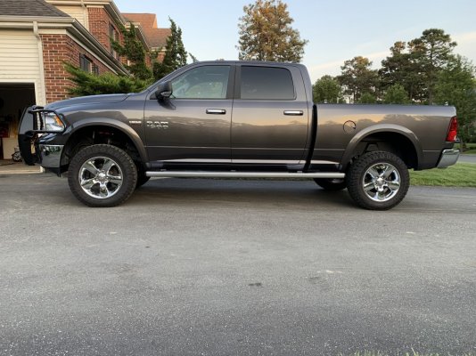

I was shopping hard for a 4" kit too a year or two ago. Researched until my eyes bled. I went with a Zone 6" kit with their UCA's. The zone 6" is adjustable so I opted to go 5" in front and 3" in back. Went with Fox 2.5's front and Fox 2" in rear. Drives like a dream. Better than stock.
This pic is with stock sized tires on the stock rims.

If your just looking for a little bit more lift than you have currently, you could do a Zone 1.5” body lift. Lots of us have this…including me. Its $105-110. But it is a a lot if work to install without a 2 post lift. It took me 10hrs and some pain lol. Total lift from stock on my truck is 4” front and 3” rear. Currently 305/55/20 or 33.2x12.5. Easily clear 35” or 325/60/20.
Front : 40.5” Rear : 41.25”
